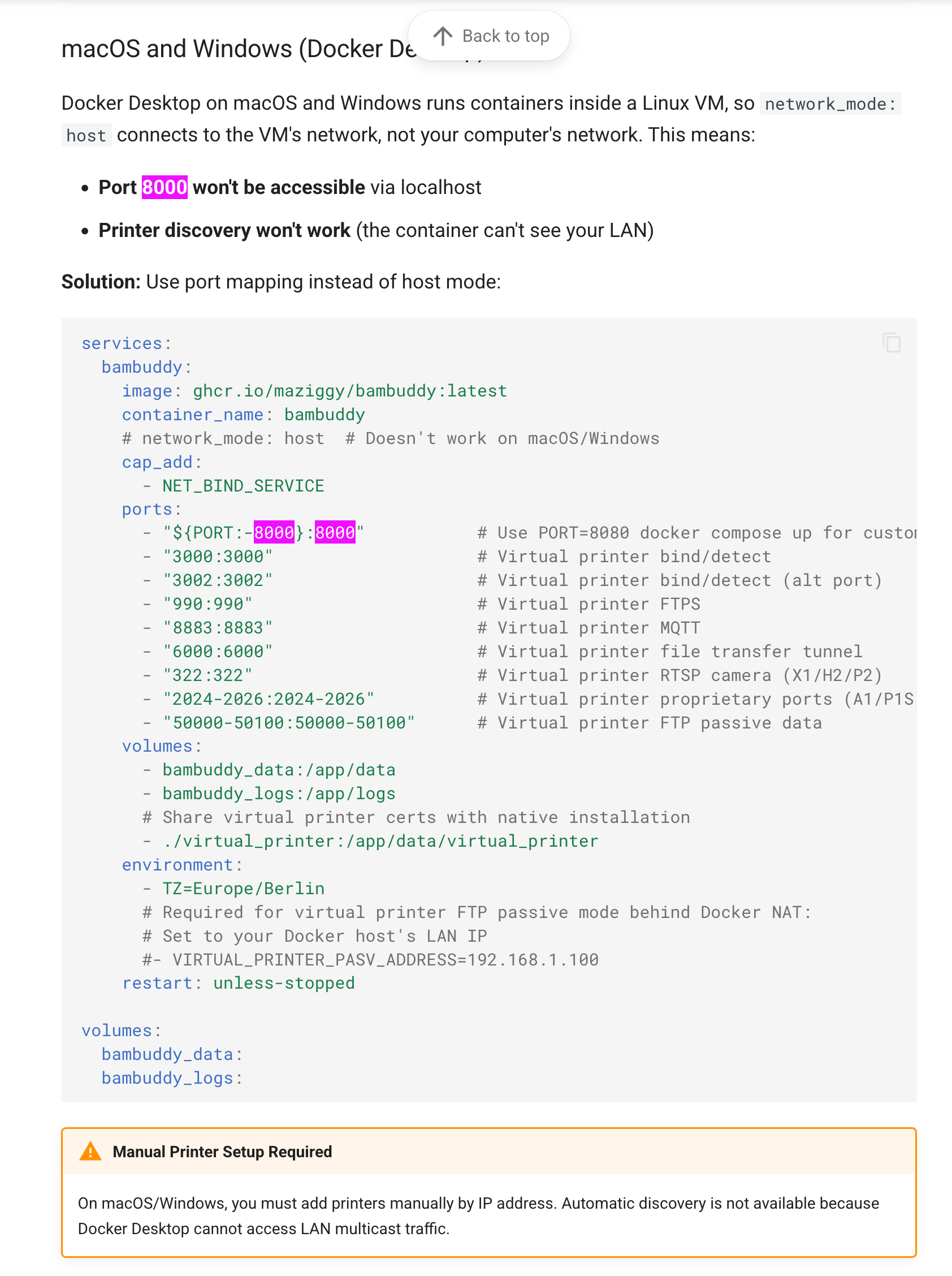

<p dir="auto"><img src="/assets/uploads/files/1779255405106-screenshot-2026-05-20-at-07.36.23.png" alt="Screenshot 2026-05-20 at 07.36.23.png" class=" img-fluid img-markdown" /></p>

<p dir="auto">Have docker container running successfully on my win 11 machine and unable to access via browser using machine IP &amp; port 8000. Browser shows refused to connect. No FW or anything special for app blocking in browser.</p>

]]></description><link>https://forum.bambuddy.cool/post/123</link><guid isPermaLink="true">https://forum.bambuddy.cool/post/123</guid><dc:creator><![CDATA[MartinNYHC]]></dc:creator><pubDate>Mon, 18 May 2026 09:27:19 GMT</pubDate></item></channel></rss>
