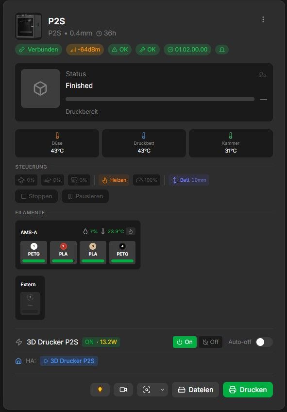

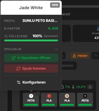

    Hi!
    Before I open a bug report, I have a question regarding the connection between Bambuddy and Spoolman.
    I set up Bambuddy and Spoolman as Docker container. Testet Bambuddy with sqlite and postgres18 backend and both have the same problem.
    I added non Bambu Lab Spools to Spoolman and connected these spools with the ams slot.
    The slot is connected with a spool with spoolman.
    I start a print and then a message came up with the information, that the spool isn't assigned and on the end of the print spoolman isn't updateing the new weight.
    Is spoolman not updating the non Bambu Lab spools, or am I misunderstanding something?

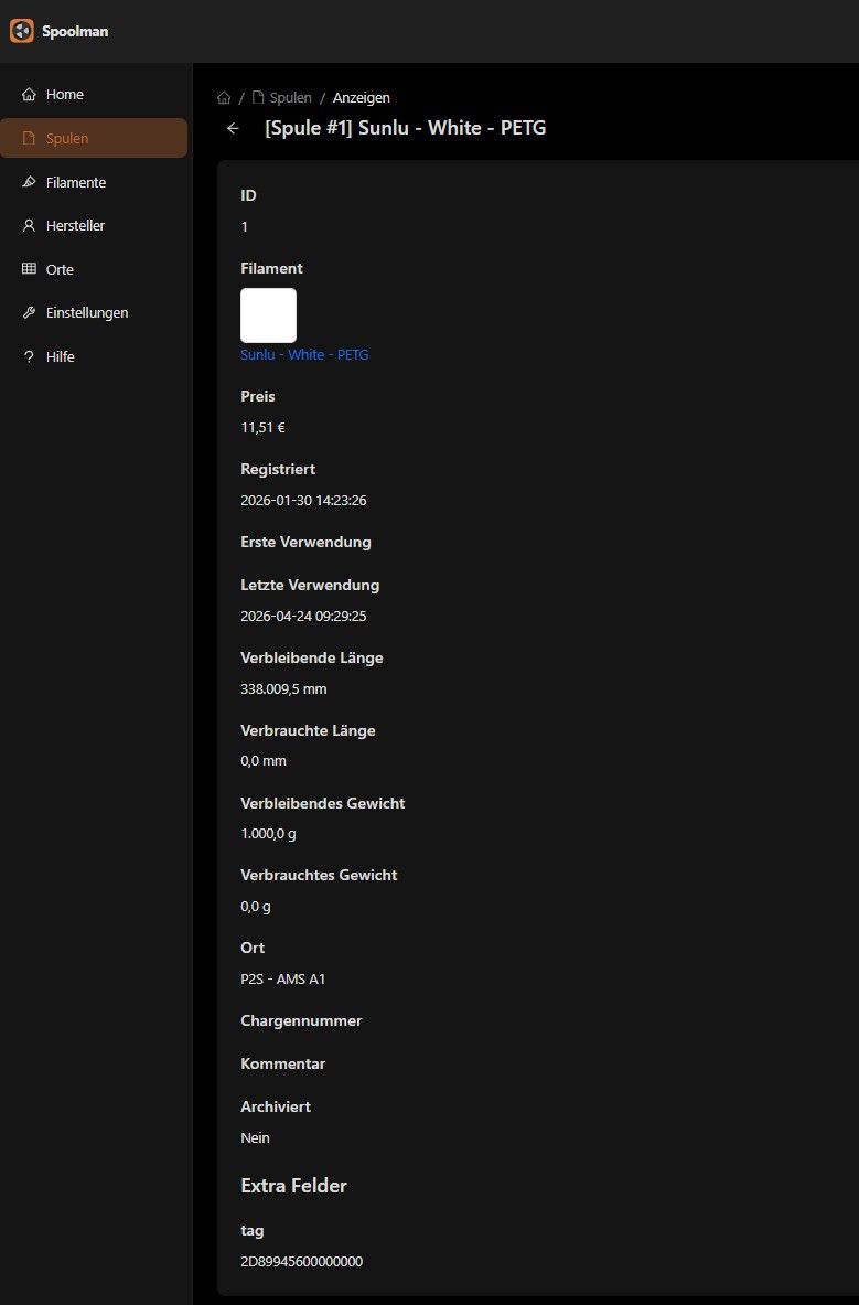

        The tables spool and spool_assignment in the database are empty.
        bambuddy=# select * from spool;
         id | material | subtype | color_name | rgba | brand | label_weight | core_weight | core_weight_catalog_id | weight_used | weight_locked | last_scale_weight | last_weighed_at | slicer_filament | slicer_filament_name | nozzle_temp_min | nozzle_temp_max | note | added_full | cost_per_kg | last_used | encode_time | tag_uid | tray_uuid | data_origin | tag_type | archived_at | created_at | updated_at
        (0 rows)
        bambuddy=# select * from spool_assignment;
         id | spool_id | printer_id | ams_id | tray_id | fingerprint_color | fingerprint_type | created_at
        (0 rows)
        Maybe I should wipe the hole installation because i installed bambuddy back in januar and updatet till now....😞
