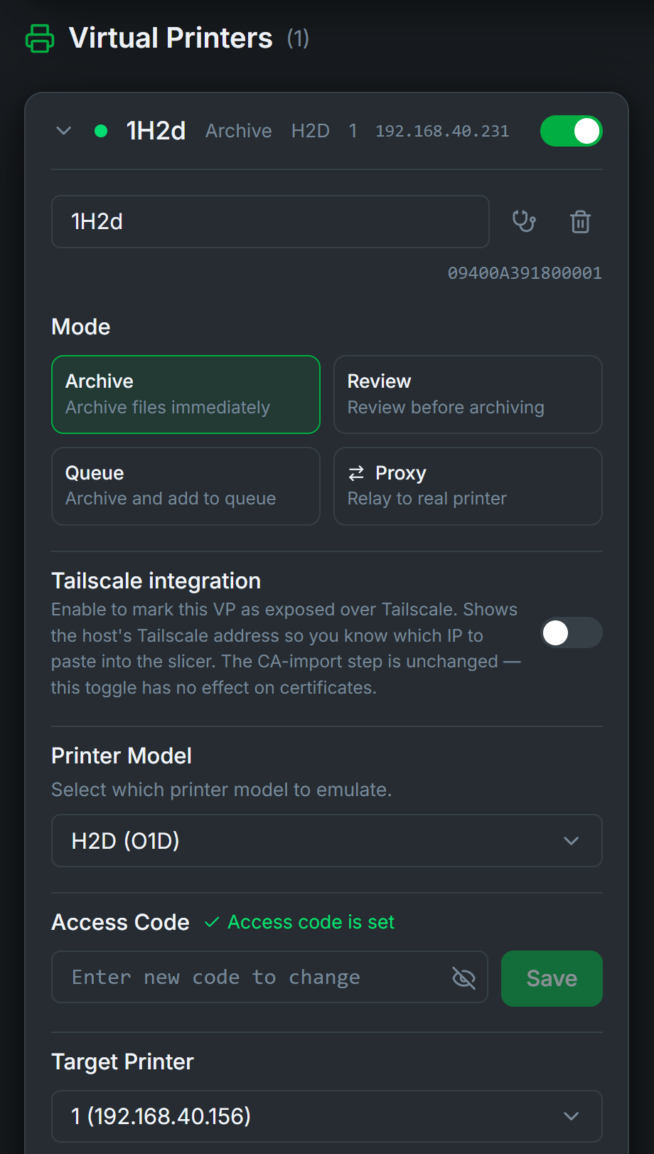

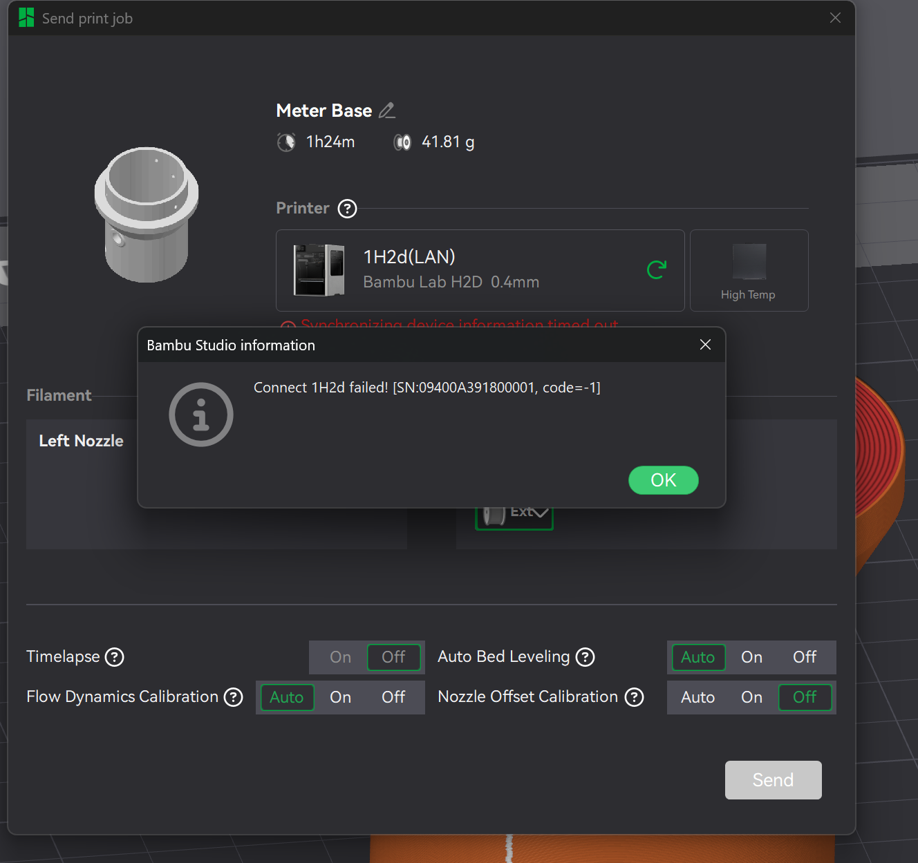

                  Ok, some good news. I installed your link but it did not work properly after opening application so I completely did uninstall of both versions and then reinstalled your link and all seems to be working better now as expected except one thing so far. I was able to add a printer and even build the virtual printer this time no problem but the slicer refuses to connect to it either from Studio or Orca.

                    #11
                    You dodn't follow th einstall instructions - the certificate is not imported.

                      #12
                      yes, I copied and pasted it at the end of the list

                        #13
                        Please open an issue on Github. Nedd to check more detailed.
