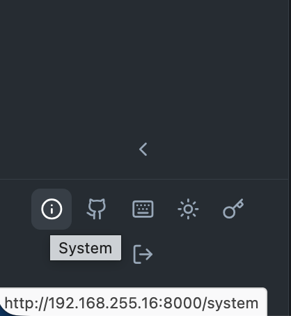

                                  trying to create an issue on Github and I cannot find the System Info page anywhere! Shouldn't it be visible in Settings somewhere?
                                  • MartinNYHCM
                                    MartinNYHCM
                                    #17
                                    • L
                                      L
                                      luke.jaeger
                                      #18
                                      AHA thanks
